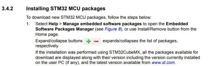

Hello @MQi.1 ,
You can download the STM32CubeL5 MCU package from STM32CubeMX (integrated with STM32CubeIDE tool) in command-line mode, or using user interface.
You can follow the instruction in the UM1718:
