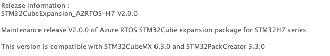

Yes, there is a pack can add to STM32cubeMX for Azrtos.
Here is the update notice I see
