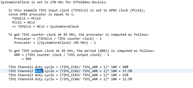

2023-09-07 2:41 AM - edited 2023-09-07 2:45 AM
Hello @Jason_fx
TIMx channels duty cycle = (TIMx_CCR1/ (TIMx_ARR + 1))*100.
You can change the values off TIMx_CCR1 and TIMx_ARR to modify the duty cycle value.

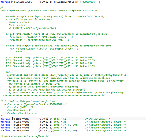

2023-09-07 5:37 PM
Hi Stassen,
Thanks for your reply.
But I have a question,
I find this code but I can't understand how to change the PULSE_VALUE,
example code is output PWM has a 90% duty cycle, if change 50% duty cycle how to set the PULSE_VALUE?

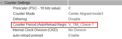

2023-09-07 6:56 PM
hello @Jason_fx
you can simply set "duty * counter-base-period" to "Compare Register" just like followings..
where V_TIM_Cbase is defined in configration as below.
hope this could help
regards

2023-09-07 9:32 PM
hello, @Jason_fx
off course join the codes into your main() or some applicable place by yourself.
and, if the Counter Period in your project is for example "999" (=1000-1), I mean V_TIM_Cbase = 1000,
then it should be refered in the code which I show you.
if your sample code is as below,
PulseVal = (uint32_t)(vfPdt * (PERIOD_VALUE + 1));
would be OK, but well.. I don't like it.
Is it OK now?
regards.
2023-09-11 8:42 PM
Hi @mxo
I can't find the ___HAL_TIM_SET_COMPARE function on the PWMOutput sample code
I tried changing #define PULSE1_VALUE (uint32_t)(1000 / 2) to #define PULSE1_VALUE (uint32_t)(50000 / 1) and it outputs 76% but I don't understand code work logic.
2023-09-14 2:06 AM
hello @Jason_fx
you can find in stm32??xx_hal_tim.h. (?? = depends on your project, I guess)
One important thing that duty must be 0 ~ 1 (or can say 0 ~ 100%).
is your sample project 'TIM_PWMOutput', right?
#define PULSE1_VALUE (uint32_t)(50000 / 1) .. means over 100% duty.
since the base period is 1000 in that sample project, pulse value should be 0 ~ 1000, or result is unexpected.
TIM_PWMOutput project only shows set duty (=pulse value) at configuration time.
better to find some other samples to understand function, then this can be enough to talk, I think.
regards.
