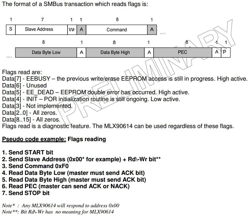

I am trying to read flag on the device MLX90614. datasaheet Page 23. The format of a SMBus transaction which reads flags is:
i.e i must send start->slave address->command and right away without send repeat start receive data. how to do it?

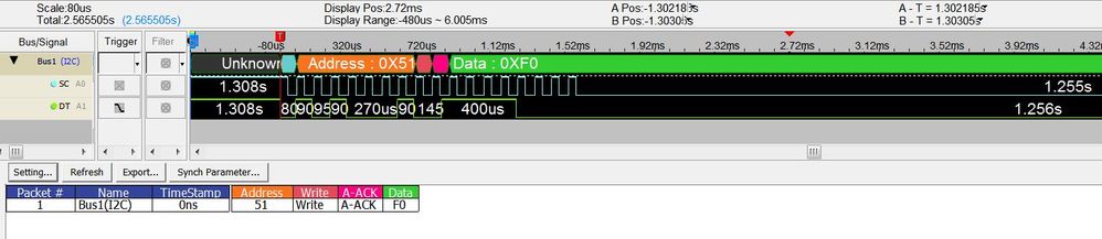

what i receive:
i2c and device working, becausei can receive and transmit data from the device(EEPROM/RAM).
I hope you got what I meant:) I will be grateful for any help.
