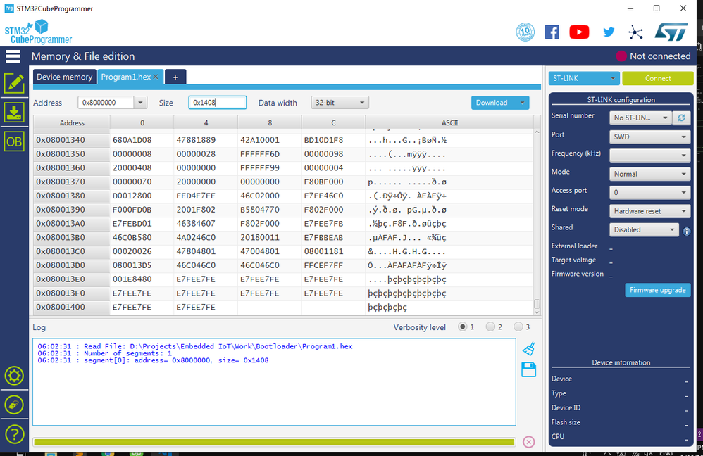

2019-03-26 3:08 AM
This is my hex file which is opened in STM32CubeProgrammer.
Could you please let me know where the last line is?
Thank you.
2019-03-26 6:33 AM
They are in ASCII, use notepad or some text editor
