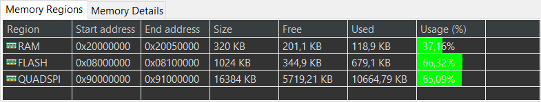

Edit :
Here is the memory used :
How to manage the variables to move them on the QSPI ?
2020-12-02 5:29 AM
