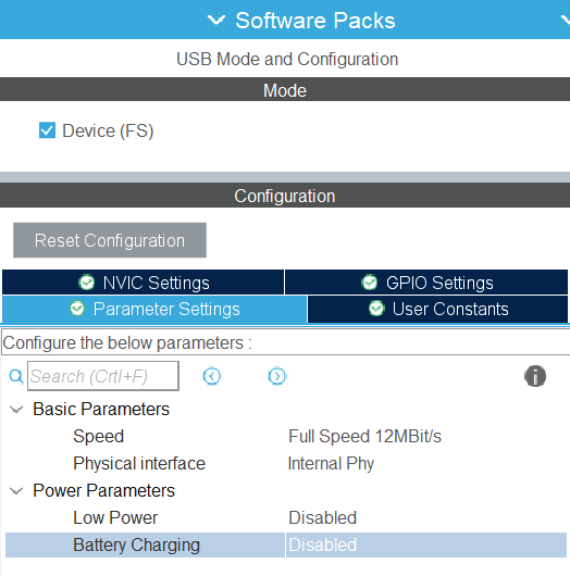

I have STM32F373 and I want to send data with USB FS.
When I generate a project, I get this struct.
PCD_HandleTypeDef hpcd_USB_FS;What should I do to send data with that struct?

Thank you. Yes I understand that. I just want to try it out and see if ST's USB is well made.

By the way! This using USB CDC. I'm using USB PCD.
The PCD (peripheral control driver) is not specific to any particular device type. Since you were trying to send data, I assumed you wanted the USB CDC device. All devices, including CDC, are implemented via the PCD.

Thank you once again!
I can see now that I need to use HAL_PCD_EP_... HAL-functions such as HAL_PCD_EP_Open, HAL_PCD_EP_Receive, HAL_PCD_EP_Transmit etc to talk to other USB devices such as my computer.
