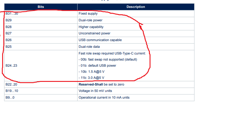

We are planning to use the STUSB4500 in one of our projects. For testing we are using the EVAL board, We are facing some difficulty understanding PDO,s Register bits while programming to the controller and we have few more questions listed below.

2023-12-04 7:43 AM - edited 2023-12-04 7:44 AM
I am reading the document UM2650 as I intend to use the STUSB4500.
Is not there a full description of the registers?
It is no help to refer to the links of the above post.
Thanks in advance.
Best regards,
Peter
2023-12-04 7:56 AM
On page 3 of document UM2650, it is stated that the bits B22...20 of DPM_SNK_PDO1_1 are reserved and set to zero. Why is the reset value 001b and not 000b. I assume DPM_SNK_PDO1_1 register contains B23....B16, right?
Best regards,
Peter
2023-12-05 6:39 AM
Hello Peter,
DPM_SNK_PDO is a 32 bits stored in 8bits register.
DPM_SNK_PDO1_0 stores bits [7:0]
DPM_SNK_PDO1_1 stores bits [15:8]
DPM_SNK_PDO1_2 stores bits [23:16]
DPM_SNK_PDO1_3 stores bits [31:24]
Thus bits [23:16] can be found in DPM_SNK_PDO1_2 and not in DPM_SNK_PDO1_1
