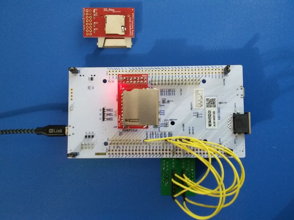

Thanks for the link. It seems the H7 are uniquely sensitive to the electrical environment of the SDIO connections. I swapped the 10K pullups on my SDcard module for 100K (didn't have any 47K) and made up some 5cm Dupont leads and now it works on a Nucleo-H7A3. Looking at the schematic for the STMH7B3 discovery board, there is no pullup on the clock signal so I have removed that one completely. The disco also has HSP051-4M10 connected on all the lines. This is a 4-channel ESD array with a rail to rail architecture designed specifically for the protection of high speed differential lines.
Why this is needed when the lines aren't differential and not remotely high speed is interesting?
It seems there is something not quite right in the electrical design of the SDIO I/F on the H7 chip. F7 and F4 don't have this problem running the bus at the same speed.
The SDIO clock is 25MHz so not remotely high speed and I can run an SPI connection to an SDcard completely reliably with 15cm leads, any value pullup (or none), at 25MHz so why if the H7 SDIO so sensitive? when SPI isn't?

Well the pin driver architecture on the H7 is different, and 4-bit mode is going to be particularly sensitive to skewing

Using NUCLEO-H7A3ZI-Q board and get it to work without any problems with STM32CubeIDE 1.3.0 just by enabling SDMMC1 and FATFS in CubeMX. It works even with internal pull-ups, don't using external as that board doesn't have SD Card slot on it, had to solder it myself. It's running reliable at 80MHz / 3.3V.
