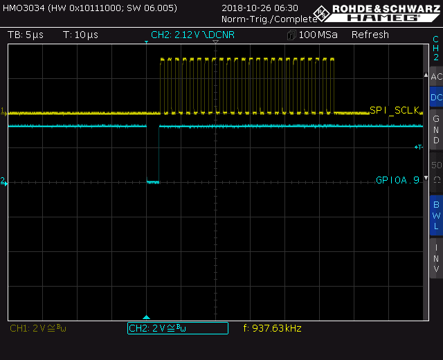

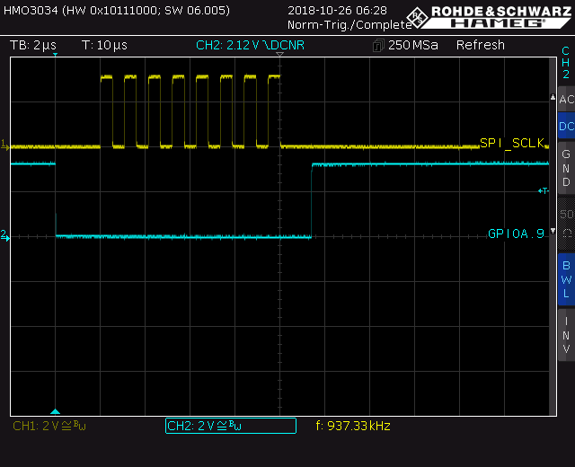

I've a problem with HAL_SPI_Transmit_IT() function as it blocks similar to HAL_SPI_Transmit.
Microcontroller: STM32F205VCT6
Compiler: arm-none-eabi-gcc, gcc version 7.3.1 20180622 (release)
[ARM/embedded-7-branch revision 261907] (15:7-2018-q2-4)
Code is generated by STM32CubeMX, Version 4.27.0
Activated peripherals:
SPI3 (Transmit Only Master), SPI3 global interrupt enabled
GPIOA.9 as output
My own code:
uint8_t buffer[3] = { 1, 2, 3 };
HAL_GPIO_WritePin(GPIOA, GPIO_PIN_9, GPIO_PIN_RESET);
HAL_SPI_Transmit_IT(&hspi3, buffer, 1);
HAL_GPIO_WritePin(GPIOA, GPIO_PIN_9, GPIO_PIN_SET);If I hand over one single byte to HAL_SPI_Transmit_IT() it does not work non-blocking as you can see at the following scope.
If I hand over more than one byte (e.g. 3 bytes), HAL_SPI_Transmit_IT() works correctly (non-blocking).
What could be the reason? Why can't I send one single byte in non-blocking mode?
2018-10-26 2:09 PM
Look at the HAL SPI source code, starting with SPI_Transmit_IT(). It enables the Tx interrupt, which fires immediately because the TX data reg is empty. SPI_TxISR_8BIT() writes 1 byte to the TX data reg. So far so good. But, since your are only sending 1 byte, the SPI_TxISR_8BIT() sees that it is done sending data and calls SPI_CloseTx_ISR() to start shutting down the SPI Tx function. SPI_CloseTx_ISR() calls SPI_EndRxTxTransaction(), which waits for the SPI to be idle before returning. So when sending 1 byte, your call to SPI_Transmit_IT() ends up not returning until the byte has been sent (shifted out), as you see in your scope traces.

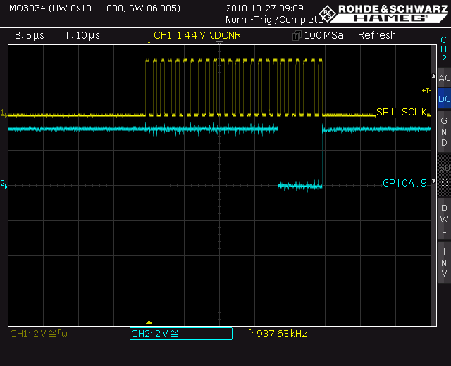

2018-10-27 1:54 AM
Hi Bob,
Thank you for the explanation.
Now let's send 3 bytes.
HAL_SPI_Transmit_IT(&hspi3, buffer, 3);HAL_GPIO_WritePin(GPIOA, GPIO_PIN_9, GPIO_PIN_RESET);
/* Check Busy flag */
if(SPI_CheckFlag_BSY(hspi, SPI_DEFAULT_TIMEOUT, tickstart) != HAL_OK)
SET_BIT(hspi->ErrorCode, HAL_SPI_ERROR_FLAG);
HAL_GPIO_WritePin(GPIOA, GPIO_PIN_9, GPIO_PIN_SET);Please have a look at the scope.
It seems that every last byte is sent in blocking mode.
I can't believe it.

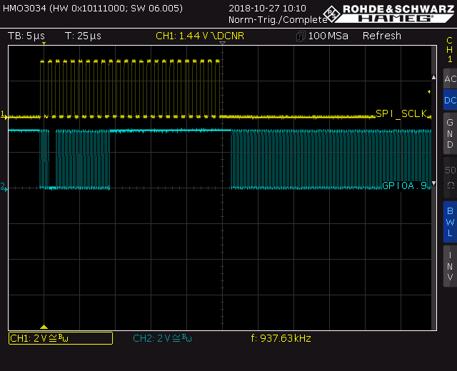

Another test:
while(true) { HAL_GPIO_TogglePin(GPIOA, GPIO_PIN_9); }This is called "non-blocking transmission". Horrible!
2018-10-27 4:09 AM
The reason is simple: the "library" wants to ensure that by the time the "finished" callback is called, data are all out. Otherwise, relying only upon the Tx interrupt only it would signal "finished" one frame earlier, when the last frame leaves the holding register and is transferred to the shift register.
There's of course a workaround, using the Rx interrupt, but even there with one of the CPHA settings you can get the interrupt a tad bit earlier than the last clock edge rolls out, so you may need to take some measures for that case anyway.
By using a "library" you decided to live with whatever design decisions the "library" authors chose. The chips have an order of magnitude more usage modes, but "libraries" inevitably implement only a limited subset, presumably of the most often used ones.
In other words: Are you dissatisfied with other's code? Feel free to write your own.
2018-10-29 8:31 AM
At the risk of paraphrasing an ex president, it depends on what your definition of "blocking" is. HAL_SPI_Transmit_IT() function is indeed written so that it (tries to) return as soon as it has configured everything to transmit (EDIT: "but the interrupt routines get in the way"). It turns out that the return is interrupted by the transmit ISR, which writes the first byte to the SPI port. If there are more bytes to send, the ISR exits. BUT, the SPI data register has a 4-byte (32-bit) FIFO. So before HAL_SPI_Transmit_IT() can return, the ISR is called a second time** to write the 2nd data byte. The ISR will be called up to 4 times, one right after the other, until the FIFO is full and the non-iterrupt code in HAL_SPI_Transmit_IT() gets a chance to finish and return. And when the ISR writes the byte it ends up waiting for the data to finish shifting out as I mentioned above.
If you really need to be doing something else while ALL of the SPI data is sent, use DMA. Though you will need to experiment and/or look at the HAL code to see what DMA does after it writes the last byte to the SPI data register (i.e. how it handles "Tx complete").
** The first ISR may actually never return, since the STM32 has logic that chains interrupt handling if an interrupt is pending when a "return from interrupt" instruction is encountered.
