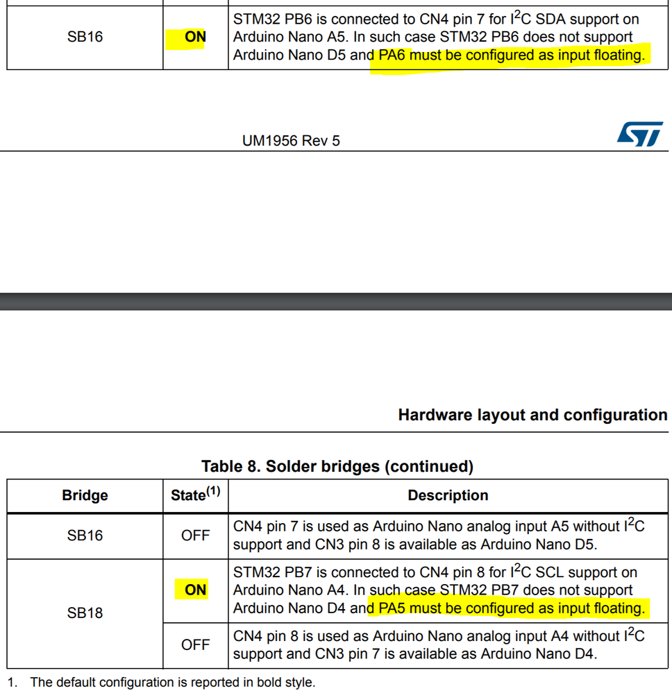

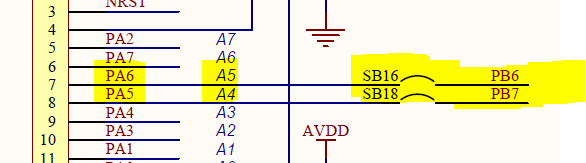

2021-01-09 1:37 PM
Also be aware of SB16/SB18 which, by default are on and connects PA6 to PB6 and PA5 to PB7.
