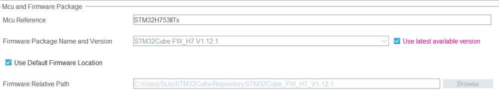

I'm using the HAL files generated by CubeMx, but it seems to me that this file is outdated, because in the header contains year 2017. It appears to me it is the same as here:
https://github.com/STMicroelectronics/stm32h7xx-hal-driver/blob/master/Src/stm32h7xx_hal_nor.c
This is my CubeMx setup:
What can I do to use the latest version?

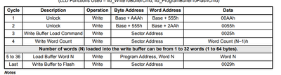

After carefully reviewing the datasheets of the IS29GL064 and the S29GL128P, it is clear that the Write Buffer Programming method differs between these two devices.
The HAL_NOR_ProgramBuffer() function in the HAL driver is specifically designed to follow the programming cycle of the S29GL128P, as described in its datasheet.
Write Buffer Programming in S29GL128P
Therefore, using it directly with the IS29GL064, which employs a different buffer programming protocol, can lead to issues such as the memfault you encountered.

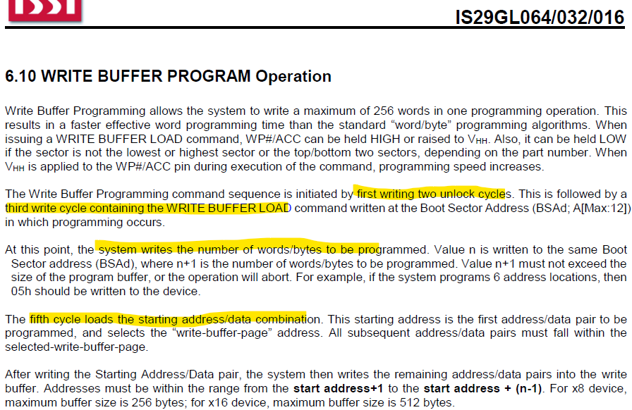

To leverage this feature with your IS29GL064 NOR flash , it would be necessary to implement a dedicated function that strictly follows the sequence and timing specified in the IS29GL064 datasheet.
WRITE BUFFER PROGRAM Operation in IS29GL064

I agree that the statemachine drawings look different, but if you compare the text in the description, programming of both flash looks the same to me:
So here, the IS29GL64 works but I don't know why. I probably have a problem when step debugging the buffer programm code. Maybe the flash aborts its internal buffer program statemachine if the debugger is reading from flash in order to read the value of a variable displayed in the debug window?
I now give a try to the MX29GL flash. Regarding the datasheet, it should work but doesn't yet. Maybe the same debugging problem? I'll get back soon.
I finally succeeded running the HAL_NOR_ProgramBuffer() on IS29GL064 and MX29GL640. To me, both flash support the program buffer feature and the programming flow is the same as for the SG29GLxxx. IMHO the HAL comment mentioned in my first post is misleading.

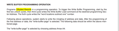

Last not least, I missed that that the MACRONIX flash does only have a program buffer size of 32 bytes.
I tried to program 512 bytes, same as for the ISSI flash, but stopped step debugging.
For test I reproduce it by setting the program buffer size to 64 bytes.

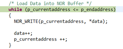

Here is the situation after the last valid/allowed write to flash
By executing the next debugger step, debugging is aborted. The following output is generated:

I guess that the debugger tried to read from an "invalid" flash memory address outside the program buffer address range. Any idea what exactly happens here?

The issue you are encountering is due to the Macronix flash memory you are using, Which supports a maximum programming buffer size of 32 bytes.
When you try to write 512 bytes (as you do with the ISSI flash) or even 64 bytes in a single operation, you exceed this limit. This causes programming errors and blocks the debugger, as you have observed.
To resolve this issue, it is essential to split your writes into blocks of 32 bytes maximum. Each programming operation must respect this size to ensure system stability and allow proper debugging.
