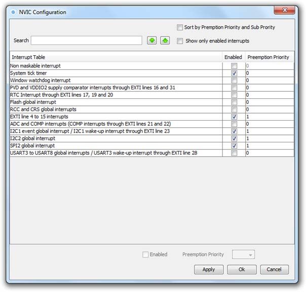

Following this note, I configured all the other interrupts with a lower priority in my STM32CubeMx project:
Unfortunately, this didn’t change anything.

You'd probably want to double check the NVIC Group configurations, and that it's actually got the Preemption and Priority levels you think it has. Look at the registers, and the documentation, don't rely on the tool doing it properly.2015-09-16 5:56 AM
