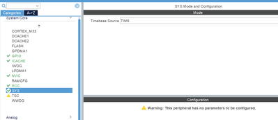

2025-03-13 8:08 PM - edited 2025-03-13 8:28 PM
Thank you @Pavel A.
the TimeBase was already set to TIM6 (screenshot below) and the HAL_Delay() does work perfectly well if I place it in the
/* USER CODE BEGIN SysInit */
section but not in the
/* USER CODE BEGIN 2 */
section.
I'm new to STM32 and the whole environment so the info I shared in my post is as far as I could go so far. Any suggestions on further tests/debug (including why it does not work)?
Thank you :)
