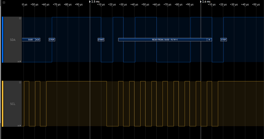

Technical environment :
- Master : CM3 (Raspberry)
- Slave : STM32F446
- CubeMX : V4.23 (even tested with V4.26.1)
- Normal transaction is : MASTER do a 4 bytes WRITE, then a 1 byte WRITE and at last, a 4 bytes READ.
The slave ACKed the WRITEs, but the READ command is NACKed by the slave (logic analyser view).
I have this problem when I have a delay (more than 1 ms) between the end of the second WRITE (STOP bit) and the HAL_I2C_Slave_Transmit_IT() call.
Without this delay, everything seems OK.

2018-09-14 12:58 AM
The ACK bit is only set after having called the HAL_I2C_Transmit_IT() or HAL_I2C_Receive_IT(). The ACK bit can not bit set before calling these functions, because they start by checking that the I2C bus is free (by testing the BUSY bit).
The FMPI2C1, present on the STM32F446 doesn't have the issue because the ACK has been replaced by a NACK bit in CR1 and the reset value allows to aknowlege in case of address match.
Best regards
