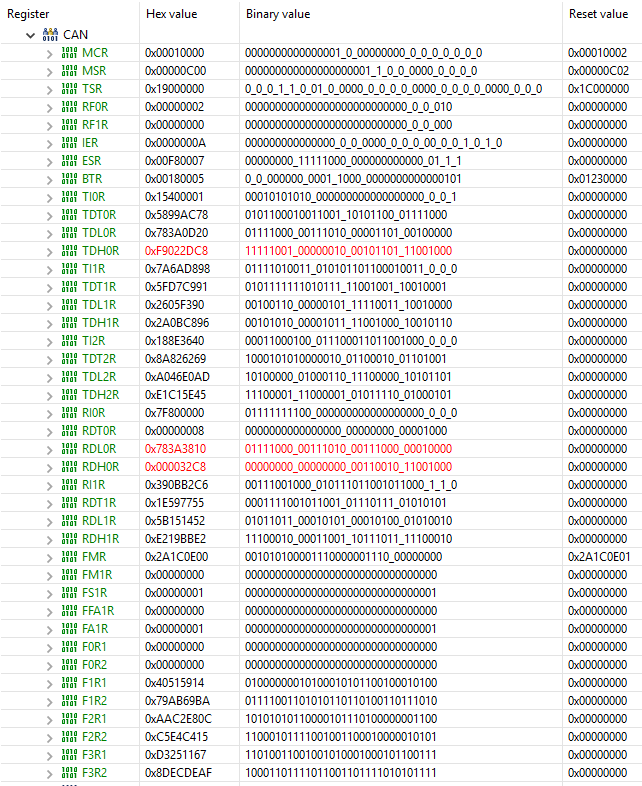

Here is a snapshot of my CAN registers right before the return HAL_TIMEOUT;

The bug gets triggert if there is a collision on the CAN bus. eg. if two devices send a frame with the same CAN priority at the same time. This will permanently lockup the TX of one of the devices.
