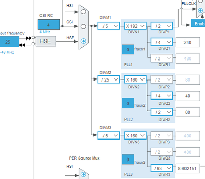

FDCAN (Classic Frame Format) Relevant Code and Calculations:

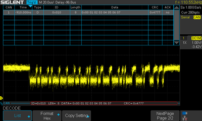

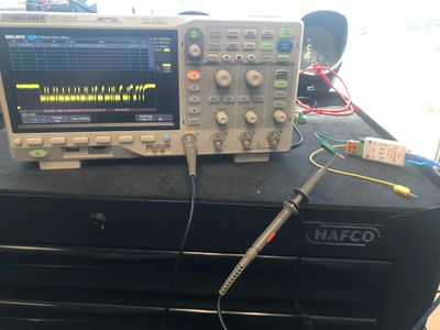

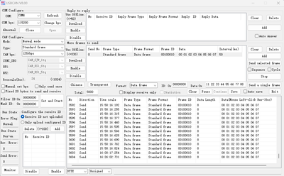

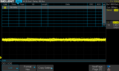

Test 1 Reading CAN form USB to CAN tool using oscilloscope:
First test was to get an idea of what I would expect to see when a single node is transmitting and to make sure I had my oscilloscope set correctly. Watching CAN LOW.

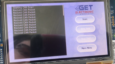

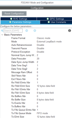

Test 2 CAN Loop Back:
Set up using the CubeMX above, I press a button on the GUI to start the transmit and then prints a message to GUI when a CAN frame is received. Works as Excepted, except noting is seen on scope. From my understanding of external mode RX still transmits out of the controller so should be visible on scope, it just won't receive any external messages? That's the first sign of the problem. By this point I'm leaning towards I've somehow damaged the transceiver, but It's got ESD protection so I'm not sure.

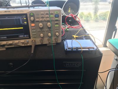

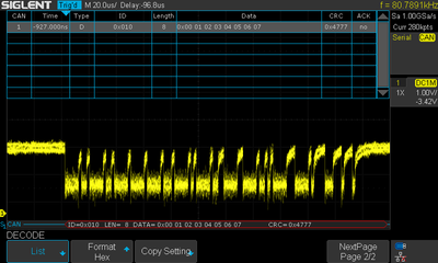

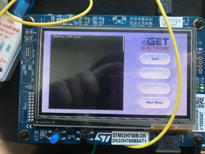

Test 3 CAN TO USB connected to H750B:

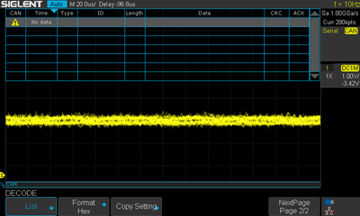

This time I connected the MCU to the USB to CAN tool with the hopes of seeing the messages from the CAN Controller only modification is changing the mode to normal in MX. Termination was enabled on both sides. I first started the CAN on the H7 with the CAN tool not sending anything. Nothing was received on the H7 as expected but it also did not transmit anything.
I then started Transmitting from the CAN tool. There were lots more frames I did not recognize this time but none of them were ACKed nor did the H7 receive anything.

For External Loopback probe directly on Tx pin not on the CAN_H and CAN_L.
