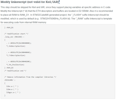

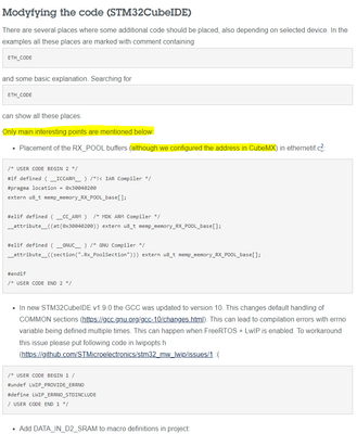

2024-02-07 2:17 AM
Hello @eduardo_reis ,
It is mentioned in this FAQ: How to create project for STM32H7 with Ethernet an... - STMicroelectronics Community : After generate project with STM32CubeIDE, you need to modify the code by placement of the RX_POOL buffers in ethernetif.c* (example with STM32H750).
/* USER CODE BEGIN 2 */
#if defined ( __ICCARM__ ) /*!< IAR Compiler */
#pragma location = 0x30040200
extern u8_t memp_memory_RX_POOL_base[];
#elif defined ( __CC_ARM ) /* MDK ARM Compiler */
__attribute__((at(0x30040200)) extern u8_t memp_memory_RX_POOL_base[];
#elif defined ( __GNUC__ ) /* GNU Compiler */
__attribute__((section(".Rx_PoolSection"))) extern u8_t memp_memory_RX_POOL_base[];
#endif
/* USER CODE END 2 */
Then, modify the linkerscript. This step should be skipped for Keil and IAR, since they support placing variables at specific address in C code. Modify the linkerscript (*.ld) that the ETH descriptors and buffers are located in D2 SRAM.
Note (*) these addresses and sizes depend on the device or core used.
For more information I advise you to take a look at How do I create a project for STM32H7 with Ethernet and LwIP stack working?
Thank you.
Kaouthar
