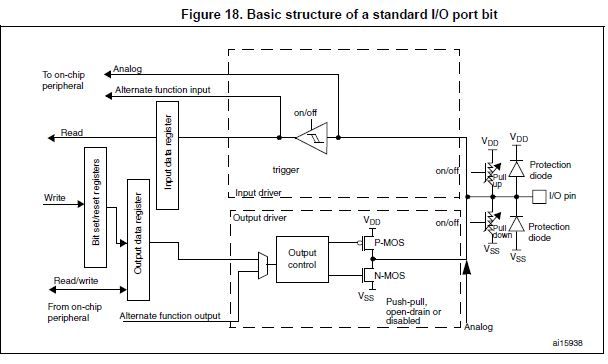

Might not be the best answer, to me the clock enable of GPIO port registers is like TIMER:
To write on the peripheral registers (for example MODER or AF) you will need these registers to have clock for read/write.
Otherwise, registers looks like read only and typically stuck to 0x0000 after reset.
2019-04-18 3:54 PM
By disabling GPIO's clock, GPIO functionality "freezes".
This means all registers preserve its values, also are not readable and return some predefined value such zeroes and can by modified by re-enabling the clock.
If an external pin configured as eg GPIO output PP and set it to HI, after disabling the clock the pin's state don't change.
So , external pins can be used as AF input or Analog modes with GPIO's clock disabled. (just configure AFRL,AFRH,MODER. etc registers appropriately before disable the clock)
