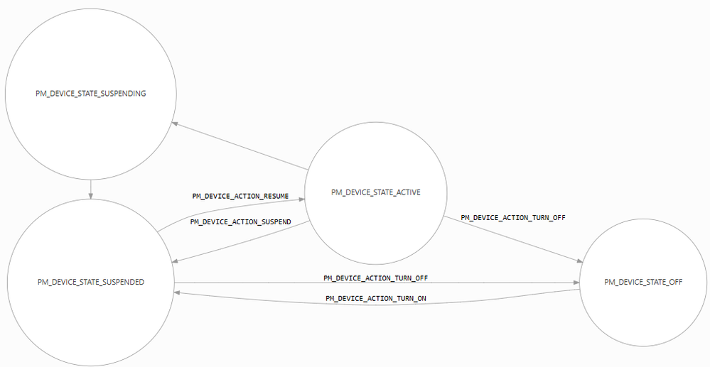

Regarding the power states, they are defined by pm_device_state. In general power states with higher indexes will offer greater power savings and have higher wake latencies.
These are the device states:
and the default state depends on the soc/board configuration, you can customize your board config to add/ delete some stop modes and transition from a mode to another after reaching the residency value!
Check: Device Power Management — Zephyr Project Documentation
