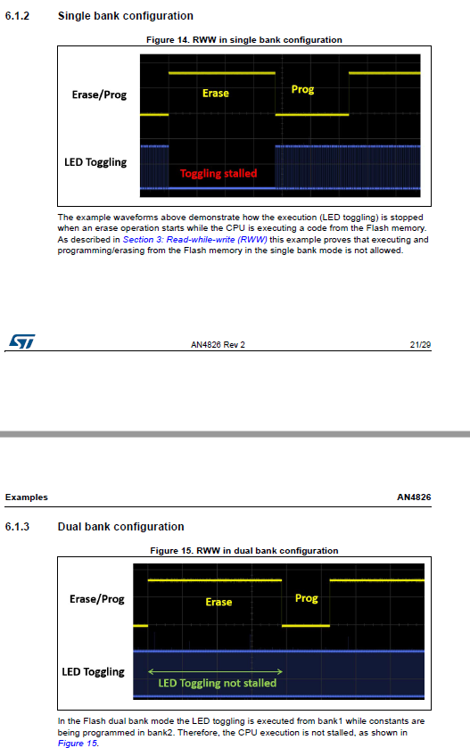

if we test with ( HAL_FLASHEx_Erase(&eraseInitStruct, &SECTORError) != HAL_OK) function there is no impact on foreground interrupts. But per design notes of dual bank concepts there should not be any hang/impact on first bank operation when we erase/program the bank 2.
is it a limitation of STM32H743 device?. or am i missing something.
i referred application note AN4826 as its a similar concept. and there it claiming the full functionality as expected but the reflection on STM32H743 is different, why?

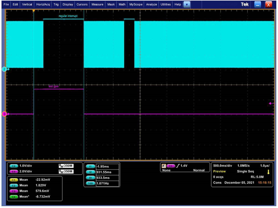

1) Timer8 triggers(TRGO) ADC SOC, ADC EOC triggers DMA interrupt. This sequence repeats with 80 K Hz Rate. For debug purpose we toggle GPIO in DMA ISR.
2) We always try to erase and program bank2 and then swap.
3) We start unlock (HAL_FLASH_Unlock()) and perform sector erase(HAL_FLASHEx_Erase_IT(&eraseInitStruct) != HAL_OK) on bank2.
4) Interrupts halted for some time(see the screen short attached with and with out interrupt function call)
5) Interrupt priority for DMA2 is set higher than the flash.(means lower number for DMA2, PRIORITY_GROUP4, no sub priority)
6)BOOT0 pin grounded with 1k resistor, core running at 400 M Hz.
I have placed one GPIO (channel 2: blue in foreground / high speed interrupt(dma2 interrupt), and other GPIO in my application layer where it triggers the flash erase interrupt API ( Channel 3: pink ).
We are updating the bank 2 with 2 sectors erase configuration (file size is 200K bytes)

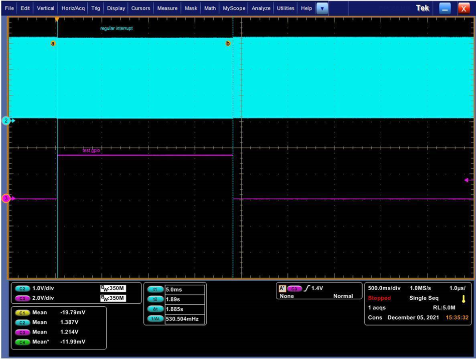

1) With HAL_FLASHEx_Erase_IT function( (HAL_FLASHEx_Erase_IT(&eraseInitStruct) != HAL_OK) ) my foreground/high speed interrupt is blocking (see attachment)0693W00000HoIA2QAN.png
2) With ( HAL_FLASHEx_Erase(&eraseInitStruct, &SECTORError) != HAL_OK){) my foreground/high speed interrupt is not blocking (see attachment)

Not real sure. That definitely shows the issue.
If your code tries to access bank 2 during that time, it'll block. In the non-blocking function, your code definitely doesn't access bank 2 as it just waits on the flag. As a test, I would call HAL_FLASHEx_Erase_IT and then go into an infinite loop and see if you still see blocking behavior. If not, that means the issue is likely in your code somewhere.
You could also disable some of the interrupts being set by HAL_FLASHEx_Erase_IT. If you disabled them all, the code should certainly not block as then it's effectively the same as HAL_FLASHEx_Erase. Might be a good sanity check. Might be good to know which flag exactly is causing it, if any.

HI i am very sorry for not posting the details as asked to close this issue. I was struck with unexpected work on priority.
The base conclusion i got: Yes as you said we are accessing the Flash while erasing to know the Bank 2 firmware version. After blocking this snip code, there is no breakage in the foreground interrupt frequency..
