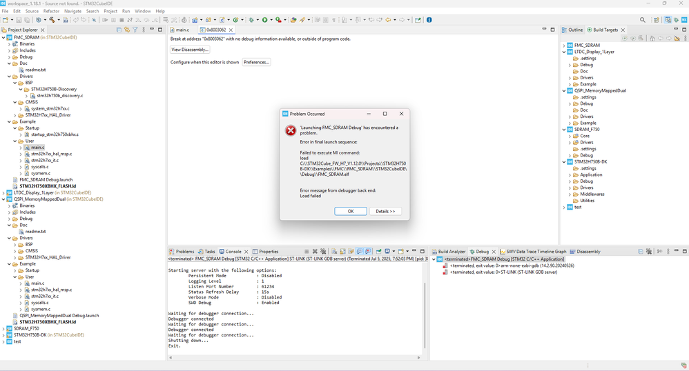

The STM32H750B-dk Based Custom Board isn't entering debugging mode when using STM32CubeIDE . But QSPI Example Code is working perfectly.

When Downloading the binary directly into the Board same error Shows up.
The Custom Board is an Exact Replica of the STM32H750B-DK with Dual Flash (same part number and SDRAM IS42s322400F Connected with the same Pins as per the EVK). However, I am unable to start the basic TouchGFX code. The board is connected using STM32CUBEProgrammer with the external loader selected, and the erase and load functions are working properly.

FMC Example through the same error as my custom board on the STM32H750B-DK.

Yes, I have cleaned the old installation files of STM32CUBEH7 Folder and cloned the above link specified by you , But the fresh FMC Code is sending out the same error
