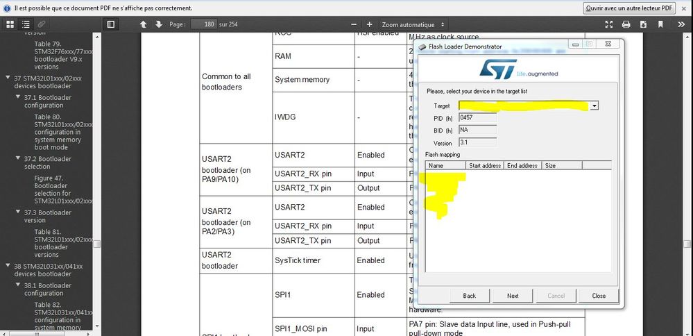

Hello imen,
Thanks for your reply, but I have a problem with the Flash Loader Demonstrator software that gives me no target.
Attached is a more explicit photo.
Thank you very much.
2017-03-03 2:42 AM
Hi enedis.ibrahim,
Here is attached a newer version of theSTMFlashLoader Demonstrator 'STMFlashLoader Demo_V2.9.0RC4' adding support of new STM32L0xx devices.
Please try with this new versionand we hope you will continue to keep us informed about your updates, if it is working as expected or you faced any issue.
I would inform you that this new version ofSTMFlashLoader will be available as soon on the web.
Regards
Imen
