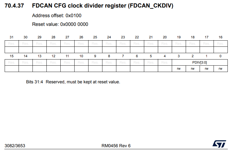

rm0456 describes CKDIV belonging to the FDCAN register structure, However the actual header in the cmsis_device_u5 repo make it a member of the FDCAN_Config_TypeDef. This is missleading!

@Uwe Bonnes wrote:
rm0456 describes CKDIV belonging to the FDCAN register structure, However the actual header in the cmsis_device_u5 repo make it a member of the FDCAN_Config_TypeDef. This is missleading!,
Is it?
The RM calls it "FDCAN CFG Clock Divider" - so FDCAN_Config_TypeDef doesn't seem an unreasonable name?
https://www.st.com/resource/en/reference_manual/rm0456-stm32u5-series-armbased-32bit-mcus-stmicroelectronics.pdf#page=3082

From 70.4.37, it could be expected that FDCAN1 -> CKDIV resolves against the device header. But it does not resolve:
#include <stm32u355xx.h>
FDCAN1 -> CKDIV = 0xa;
> arm-none_eabi_gcc ...
/devel/stm32u5_fdcan/lv2_splitter_u535/../fdcan.c:378:12: error: 'FDCAN_GlobalTypeDef' has no member named 'CKDIV'
378 | FDCAN1 -> CKDIV = 0xa; //divide by 20

Issue is that RM0456 talks about  FDCAN_DIV that is not defined in the device header To set the divisor FDCAN_CONFIG is needed, but this structure is not covered by rm0456. Device header and Reference manual should be in sync.

Yes, CKDIV is in the headers but for the FDCAN_CONFIG register set. But the reference manual describes if for the FDCAN register set.
  __IO uint32_t TXEFS;        /*!< FDCAN Tx Event FIFO Status register,                             Address offset: 0x0E4 */
  __IO uint32_t TXEFA;        /*!< FDCAN Tx Event FIFO Acknowledge register,                        Address offset: 0x0E8 */
} FDCAN_GlobalTypeDef;
  * @brief FD Controller Area Network Configuration
typedef struct
  __IO uint32_t CKDIV;        /*!< FDCAN clock divider register,                            Address offset: 0x100 + 0x000 */
       uint32_t RESERVED1[128];/*!< Reserved,                                               0x100 + 0x004 - 0x100 + 0x200 */
  __IO uint32_t OPTR;         /*!< FDCAN option register,                                   Address offset: 0x100 + 0x204 */
       uint32_t RESERVED2[58];/*!< Reserved,                                                0x100 + 0x208 - 0x100 + 0x2EC */
  __IO uint32_t HWCFG;        /*!< FDCAN hardware configuration register,                   Address offset: 0x100 + 0x2F0 */
  __IO uint32_t VERR;         /*!< FDCAN IP version register,                               Address offset: 0x100 + 0x2F4 */
  __IO uint32_t IPIDR;        /*!< FDCAN IP ID register,                                    Address offset: 0x100 + 0x2F8 */
  __IO uint32_t SIDR;         /*!< FDCAN size ID register,                                  Address offset: 0x100 + 0x2FC */
} FDCAN_Config_TypeDef;
 Either it is offset 0x100 of FDCAN_GlobalTypeDef or offset 0 of FDCAN_Config_TypeDef.
