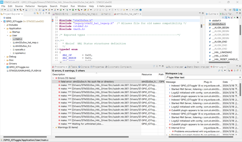

I am testing the development board STM32U5A9J-DK with THIS and trying to run the GPIO Toggle example program. But during the build process I get the error fatal error: stm32u5xx.h: No such file or directory.
I am using CubeIDE version 1.14.1.
How to fix this problem?

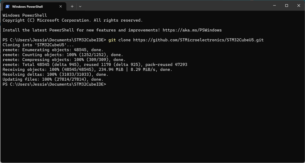

Hi, I'm glad to hear from you. I've re-downloaded the project using git and I'm still getting the same error, what else can I try?

I didn't try this specifically, but the git command worked for me, thanks for the answer!
