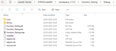

2025-01-23 4:54 AM
The ELF file does exist.
