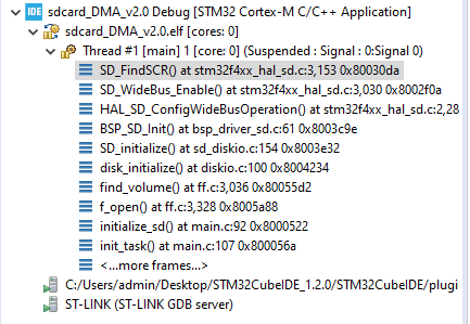

I tried to interface a SDcard but at f_open instruction system goes to SD_FindSCR() function in stm32f4xx_hal_sd.c and stuck there in a infinite loop.
The image for my stack is as below:
