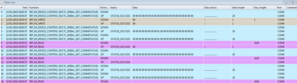

I use a serial port monitor provided by Eltima. I will attach a screenshot showing that only an "i" was sent. However, my hpcd->OUT_ep->xfer_buff and eventually my UserRxBuffer fills with "i€‘" also known as 0x69 0x80 0x91. This is when using terraterm. But if I were to use a different terminal program, I would see a different message.
I have actually solved this issue by saving the length of the message received in a static variable to access later. This length gets passed through the callback structures of the interrupt. Previously I had been calculating the length of the message buffer with a strlen command. The moral of the story being, don't ever calculate the length of the received buffer on your own when using STM32F7 USB device drivers. Use the length that they give you in the callback. The read buffer gets filled with all kinds of nonsense that varies depending on all kinds of factors, but the beginning of it will be the correct message.
