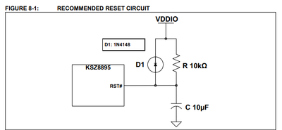

after a quick look in the documentation of the KSZ8895 a general recommendation is to make sure that you are respecting the Reset circuit recommendation from the manufacturer (see KSZ8895MQX/RQX/FQX/MLX Integrated 5-Port 10/100 Managed Ethernet Switch with MII/RMII Interface (microchip.com) section 8. Reset Circuit)

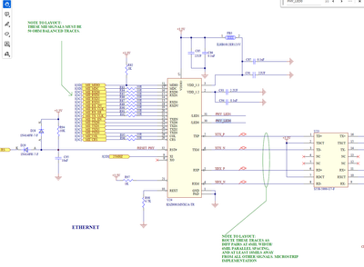

Below is the example of KSZ8081 based schematic. I have also attached stm32_ethernet.c. Relevant functions are
stm32_phyinit() which resets the KSZ8081 phy and sets up auto-negotiate or speed. It is called by stm32_ethconfig which also calls stm32_ethreset where SWR bit is set and waits for it to be cleared.
Here is the rest of the schematic for KSZ8081

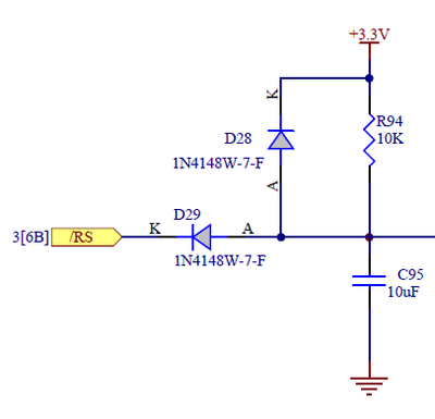

I have tried to simulate the reset circuit i don't know the reason behind adding the D29 diode and from my side I see that this diode is preventing the PHY from resetting Hince not being able to asset the SWR reset in MAC side.
can you please probe the output of the reset circuit and confirm this, maybe try to remove or bypass this diode and see if that changes behavior on the reset going to the PHY.
here is what I see:
BR
Hello BR,
My EE confirmed that the ethernet chip IS coming out of the reset. He also confirmed that he didn't find any use of D29 as well and removed it for the testing.
