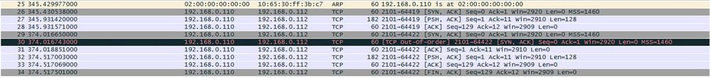

Here is the Message got from sharkwire which shows the message timestamp.
64 bytes length
128 bytes
