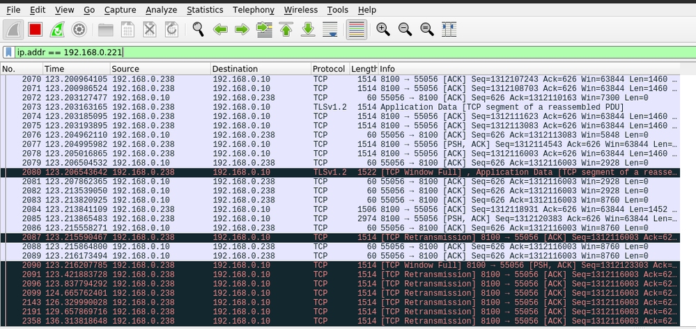

I've been using the STM32H7 example which uses the new reworked Ethernet driver (https://github.com/STMicroelectronics/STM32CubeH7).
Changed the application layer of the example (LwIP_HTTP_Server_Netconn_RTOS) and during larger transfers, the DMA error (ETH_DMACSR_RBU) occurs and simultaneously Wireshark shows that the communication has issues (retransmissions, tcp window full) and the communication stops for a while.

}Here is the Wireshark picture which shows the issue:
How can this be fixed?
