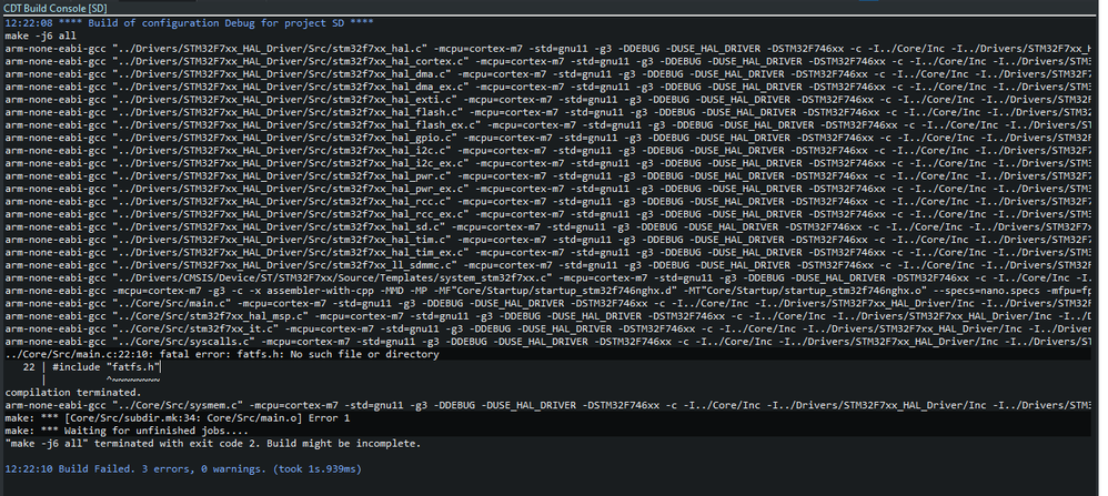

I was following the video "STM32 – Creating a File System on a SD card" from the ST Youtube channel.
I done stricty the same things as in the video but an error occurs.
../Core/Src/main.c:22:10: fatal error: fatfs.h: No such file or directory
22 | #include "fatfs.h"
compilation terminated.I tried to enter manually the include path for all the files concened but many new errors are rising.

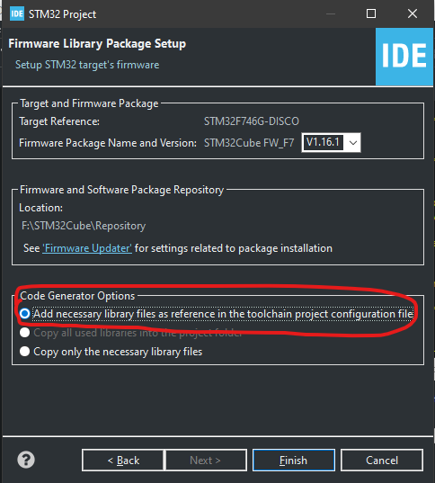

Issue solved !!!!
I just changed some parameters :
1 - change the repository path (mine was a problem because i was having a "ç" in the name via the firmware updater
2 - when creating a project : select the first option : add necessary library ....
Tadam !!
