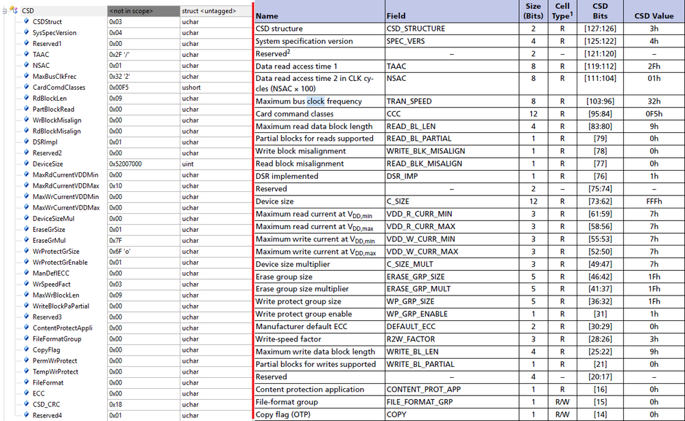

I`m trying to build project for STM32H743 with STM32CubeMX, and use eMMC for my storage space.
eMMC : Micron 4GB
Manager File : FATFS
This is the (Left)CSD Register it retured & (Right)the Micron datasheet
And I have no ideal about
MaxRdCurrentVddMin,
MaxRdCurrentVddMax,
MaxWrCurrentVddMin,
MaxWrCurrentVddMax, are all zero,but the true value is not.
Can anyone help?
I`ll really appreciate.
