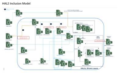

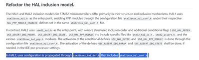

- stm32xxx_hal_conf.h is included by the hal_def.h only. There a indeed some issues in the doc : here
we will fix this page: note that this is transparent for the user, all what the application needs is to have the stm32xxx_hal_conf.h at it's side, knowing that the stm32xxx_hal_conf.h is provided as a ready to use template.
2025-07-14 4:52 AM
regarding the point :
Finally, after double-checking, the document is correct according to the references provided here (see also below).
I now understand that your point is not about an issue in the document (my mistake, sorry), but rather a proposal to make the hal_conf.h more visible.
As you mentioned, this is a minor point: the stm32xxx_hal_conf.h file is provided as a ready-to-use template in the package (in . All our examples use this file, and there is no change compared to HAL1 regarding this specific aspect.
From an architectural perspective, we include the stm32xxx_hal_conf.h in the lowest-level header file of the HAL inclusion model, which is stm32tnxx_hal_def.h. This approach ensures that the stm32xxx_hal_conf.h is easily accessible in the inclusion path of all peripherals HAL PPP drivers. And so make all the HAL configuration items defined in stm32xxx_hal_conf.h visible to all the peripherals HAL PPP drivers

My query was, would it better to include stmxxx_hal_conf.h early in stm32_hal.h so users inspecting the code will see it easier, with less include nesting? Of course if there's no other reasons to keep it that way.
