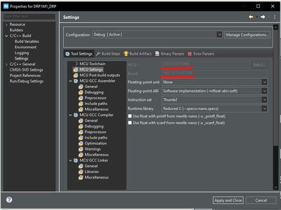

2023-10-19 12:16 PM
Thank you for the response,
It seems that the device setting in the project configuration is greyed out and cannot be changed:
Is there a different place I should be looking to change the device?

2023-10-19 11:56 PM - edited 2023-10-23 12:06 AM
Currently STM32CubeIDE doesn't support the feature to switch project from one MCU to another.
You can generate your project with STM32CubeMX as a stand alone tool and select STM32CubeIDE as target IDE.
For more details, please have a look at this article: MCU1 to MCU2 migration option within STM32CubeIDE.
Please note that we also have a wiki on how to build a DRP here. You could also follow it for a G0B1 target.
Best regards
2023-10-20 9:23 AM
Thank you, that guide is exactly what I needed.
Nate
