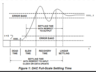

The DACs are
So driving them faster than the given settling time produces no "error" , just the output signal quality gets worse.
Only after settling time the output is at its final value, so driving it faster is no problem,
but signal is not as good any more.
The best qualtiy, as given in ds, you get by driving them at the max. speed, or slower.

2025-07-23 3:58 AM - edited 2025-07-23 4:03 AM
The DACs are
