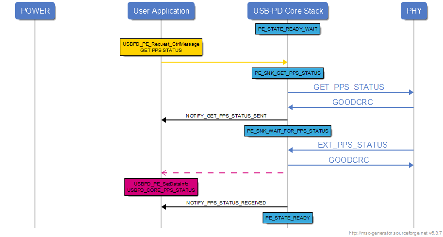

2020-05-07 8:45 AM
Dear Alex,
No only request is automatically sent by the stack (this is mandatory by the specification, refer to definition of tPPSRequest timer, "Request Message requesting a PPS APDO is sent periodically as a keep alive mechanism").
It is up to application to send a GET_PPS_STATUS message. Yes you can trigger it through the API 'USBPD_DPM_RequestGetPPS_Status'.
You should be informed by the PPS_STATUS through the notification 'USBPD_DPM_SetDataInfo(USBPD_CORE_PPS_STATUS)'.
Please find a Message Sequence Chart linked to this scenario:
Regards,
Yohann
2020-05-07 6:40 PM
Yohann,
Thanks for your information. I tried the PPS sink mode, it works exactly as you described.
Best Regards,
Alex
