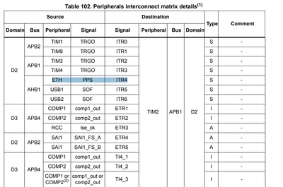

indeed, the output signal PTP "PPS" signal can be mapped to trigger a timer which can be used as a timebase to synchronize the H7 clock or synchronize the HSI drift as shown here.
this can be quite a demanding task to do and to get it working precisely as the you will lose the Syncro capabilities and order of magnitude.
