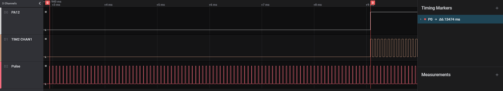

I'm trying to align an input 15 kHz signal with a 20% duty cycle with an output 15 kHz signal with a 50% duty cycle. To do this I'm hooking up the input signal to a direct capture interrupt and Timer 1 Channel 4 and using the HAL_TIM_IC_CaptureCallback function to begin my PWM timer. In doing this I notice a significant delay of 6ms as shown in the picture below. I need the delay to be on the order of 1-2µs not 6ms. Is this possible using the STM32 L476RG operating at 80 MHz? Otherwise, what are some common solutions to meeting these kinds of timing requirements?

}Here is the delay on the logic analyzer:

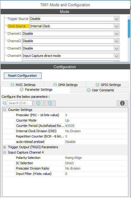

How can I make sure the timer IC is ready? The only line of code I have outside of the default and ISR is HAL_TIM_IC_Start_IT(&htim1, TIM_CHANNEL_4) which I call in the main function before the loop. Here are my timer 1 settings:
