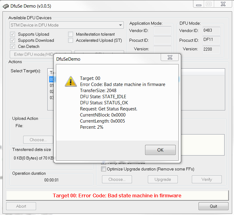

Hello Everyone,
I am have a problem using Dfuse (v3.0.5) with my STM32L432KC.
I have a USB CDC class, not using a composite CDC-DFU.
Performing the DFU mode through the boot pin/bit.
During upgrade I got the following error:
After several times (may differ), I can do the upgrade.
Has someone already solved this problem or have any advise?

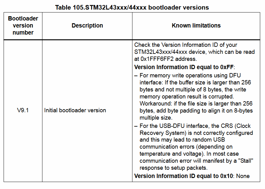

2018-05-28 1:17 AM
Turvey.Clive.002
, did you get any trouble with DFU and clock?I have read that they're might be DFU limitations.
I have a version information ID = 0x So no known limitations.
but still wondering if they is any.
