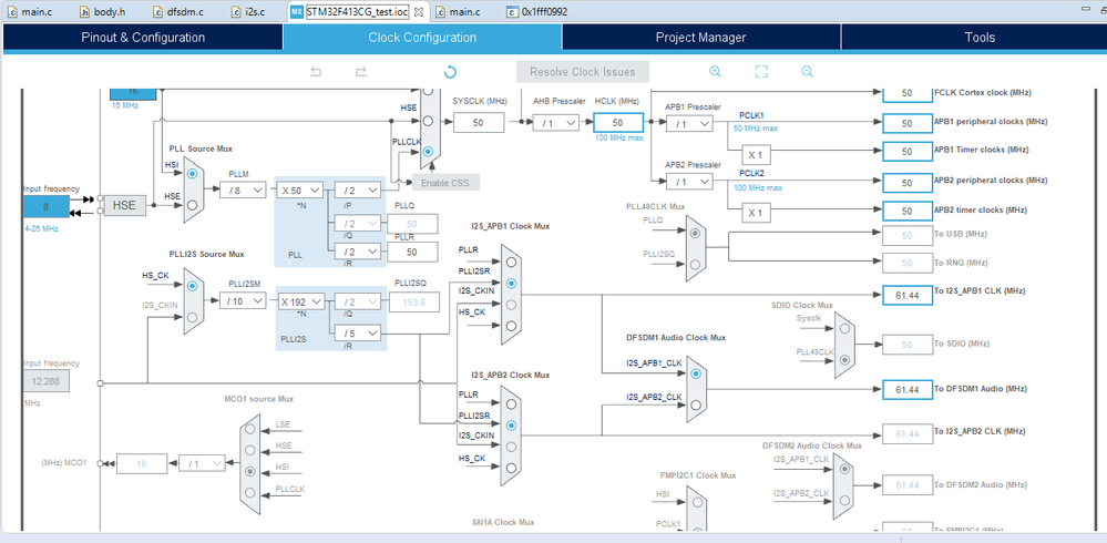

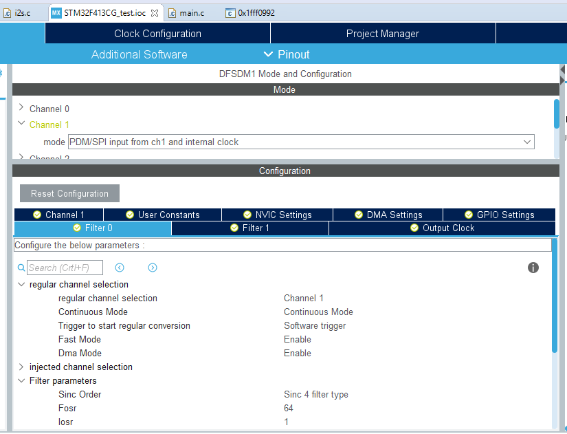

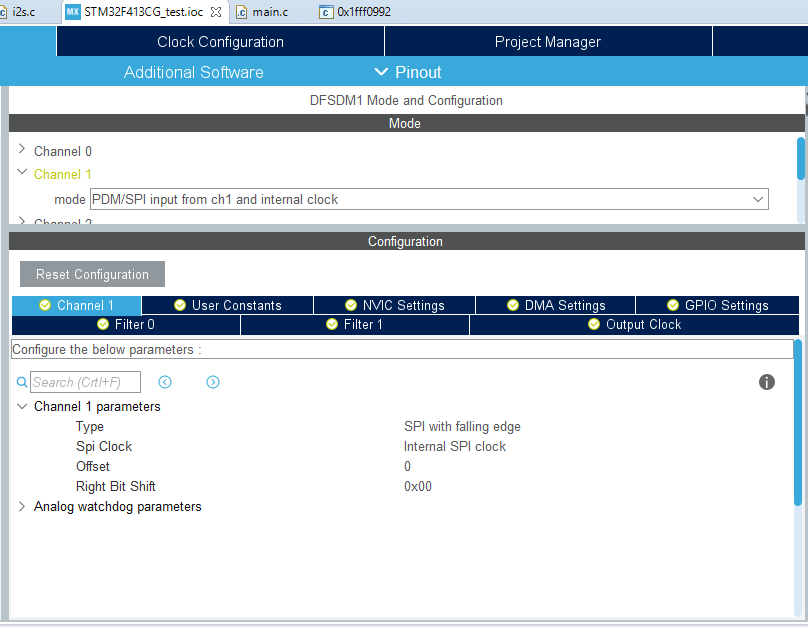

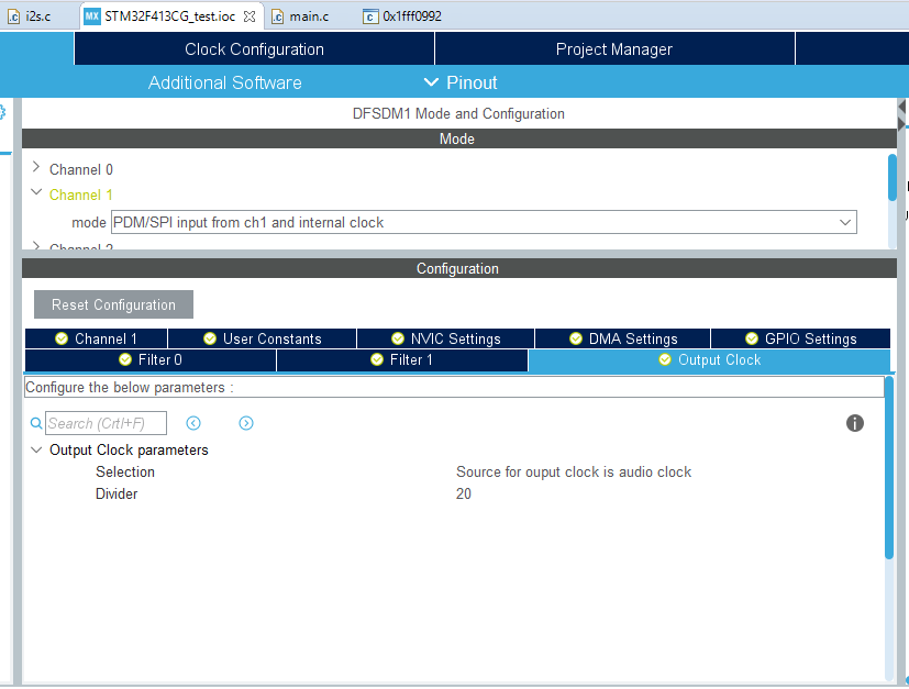

I am running DFSDM audio clock at 61.44MHZ and clock divider is 20 , FOSR = 64 , Sinc 4 Filter , right shift =0

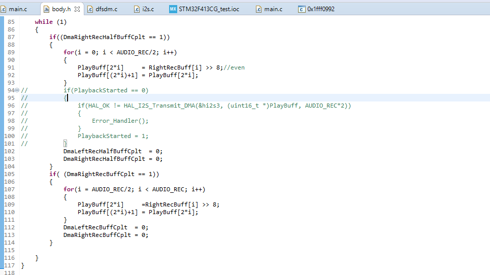

my problem is that DFSDM output array values are wrong larger than expected even after array >>8 , I got
