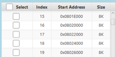

Hi Radoslaw,
As per the memory organization of the stm32l4S5 controller the address 0x08022204 is part of the page17.
I think we are missing where to change the linker address and vector address. can you please specify what more information is required from our side?
