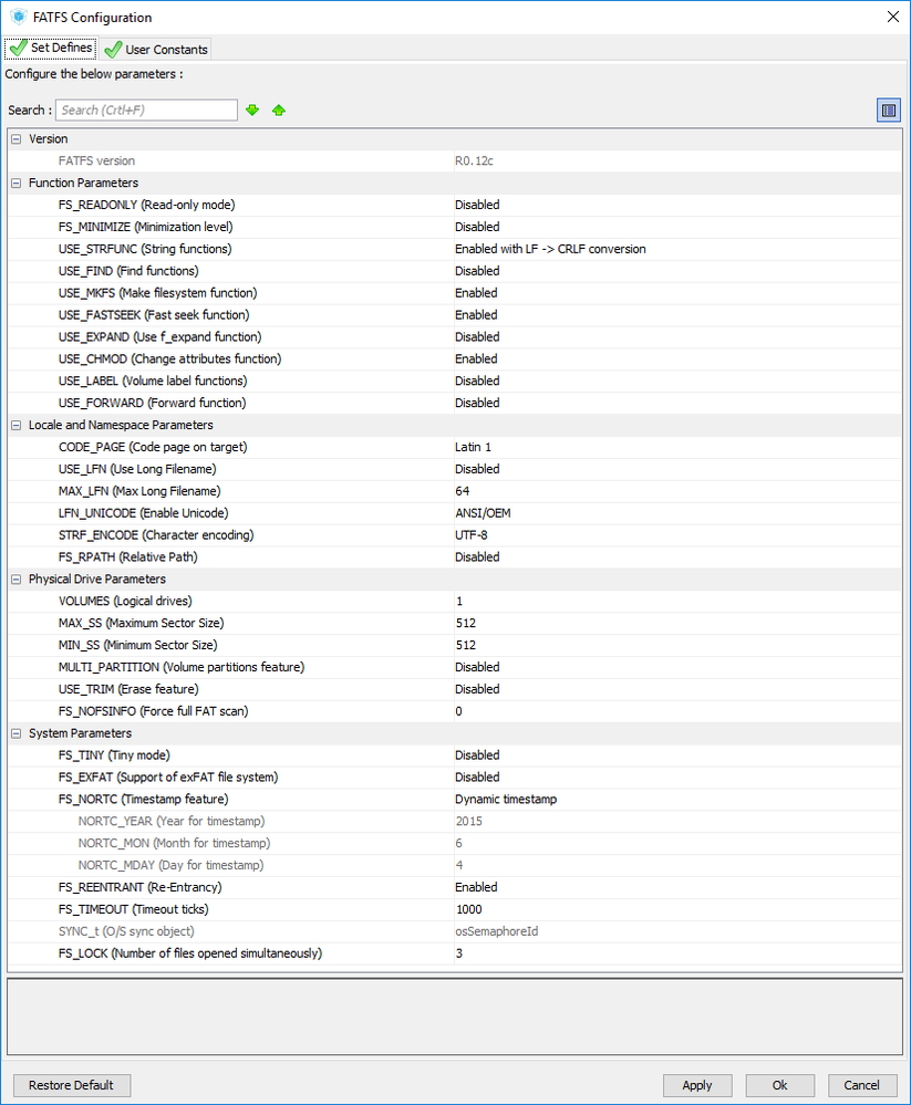

- Fat parameters:
I am generating the code for truestudio.
