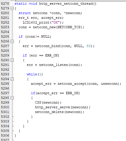

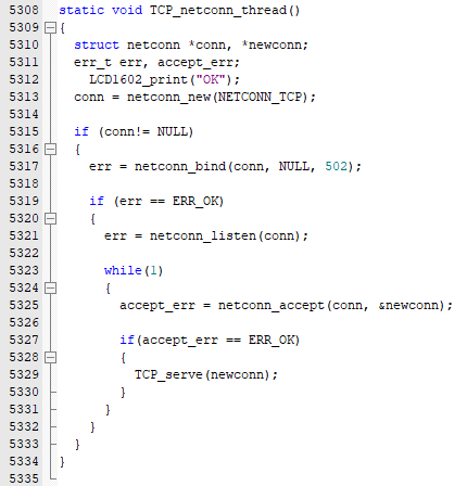

I'm trying to create two TCP servers on the STM32F767ZI microcontroller. I created my first server which is a WEB server (port 80). And now I would like to add a second TCP server (port 502). I created a second thread thinking that it was working and unfortunately, no.
If you can enlighten me on this subject which is for me new.
Init servers
Webserver
Other server

I forgot to say that my two servers works, but not simultaneously.
2018-05-15 8:03 AM
I found how to do it, we need to change the stacksize of a heart, decrease it.
