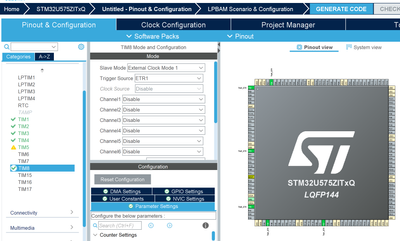

Use 6 different timers in external clock mode and hook up each channel to the ETR signal. The chip has enough of them.

Hello @ram_jana
You can use external clock mode as suggested by @TDK or configure the timer in input capture mode.
Please check the example below:
