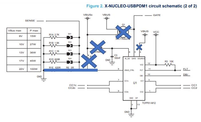

We have a wide-input power management ic with buck-boost converter. 28V VBUS is not a problem. So is it possible to eliminate the N-MOSFET (at least in Sink mode)? If it is OK, what is your recommendation for connections of IN_GD, Gate, and Source pin?
1 ACCEPTED SOLUTION
Accepted Solutions
MROUV.1
To disable Vbus OVP (when DC/DC on Vbus is 25V compliant), you need to:
  • Remove MOSFET on Vbus
  • NC : SOURCE (4), GATE (5)
  • IN_GD (8) : connected to 100nF
  • VBUS_CTRL (6) : connected to GND
See X-NUCLEO-USBPDM1 modification.
