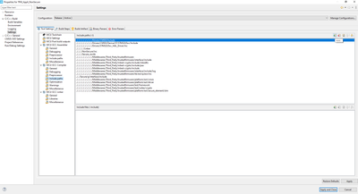

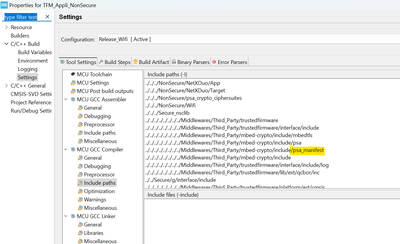

2024-05-06 3:32 AM - edited 2024-05-06 3:47 AM
Hi @bay
Can you double check if the paths of files exist and be sure that paths are correct in you STM32CubeIDE project ?
You can update or add non-existing paths as follows:
- go to project properties
- go to C/C++ Build -> Settings -> MCU GCC Compiler -> Include paths
Then correct the paths if paths were wrong !!
If any path is not available, you can add it by clicking on (+) at the top right of include paths windows.
Another suggestions, if all exists and not working, try to avoid any special character like + that I can see in your path.
Try also to avoid very long paths or spaces ....

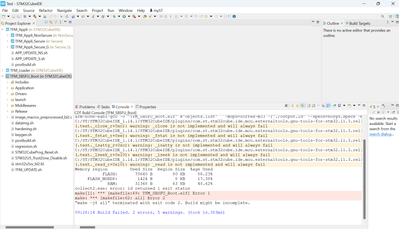

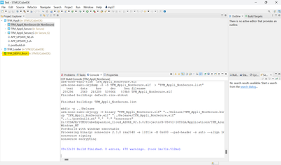

2024-05-06 6:37 PM - edited 2024-05-06 7:59 PM
Hi CMYL,
I have re-extract the folder into shorter path and remove the special character.
And before and after I added the path, can build the project successfully but with 470 warnings and the TFM_SBSFU_Boot project getting errors.

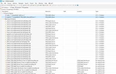

2024-06-19 4:18 PM - edited 2024-06-19 4:18 PM
Hi @bay
There is no information in this snapshot that can help to understand the errors.
Can you start from the beginning of the console and copy the full messages ?
