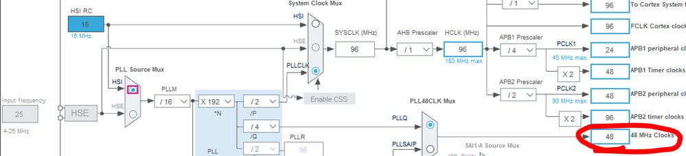

> #2 There are a lot of variables with "PLL" in them. Which ones do I set and where (I'm guessing in system_stm32f4xx.c)?
Run CubeMX with your chip for a good visualization of the clock scheme. You need to ensure the "48 MHz" clock is 48 MHz, which typically comes off of PLL1Q.
Typically clock settings are set in SystemClock_Config().

Thanks for the response. Valuable advice, especially that about the clocking tree.
