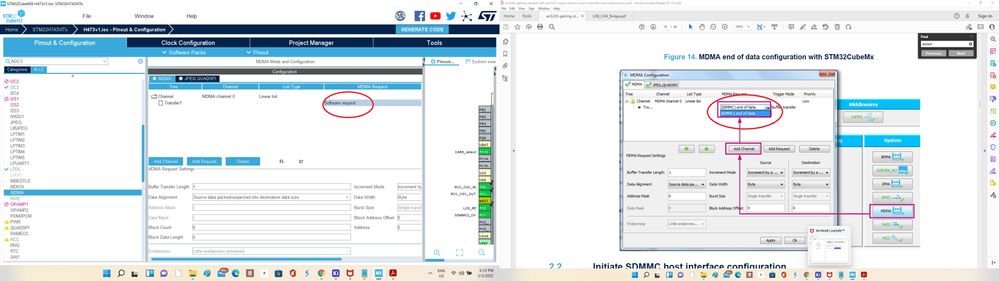

Please note the slight difference between AN5200 MDMA config and my CubeMX MDMA, as shown in figure below:
BR
