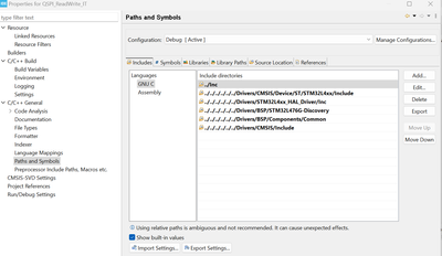

Did you update include/source paths in project properties correctly?
2025-07-29 3:46 AM
Hello @Saket_Om ,
How to update these source paths in projects. I just copied only the particular example project folder to my desired location and opened it in STM32CubeIDE. Then it shows above error.
What and How should I change after opening this project in IDE, please tell ?
2025-07-29 3:59 AM
Hello @Sudarshan
Please follow these steps:
